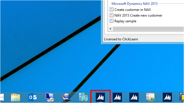

First, start the required application.
Click on the button NAV 2015 English.

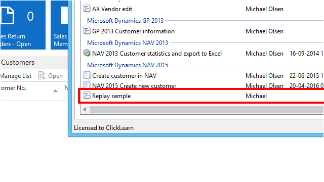

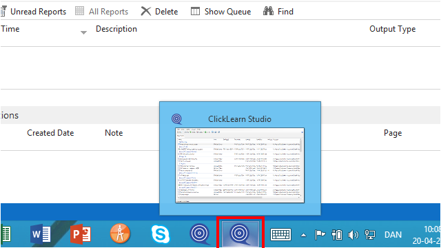

Then, activate ClickLearn and select the recording to replay.
Click on the button ClickLearn Studio.
Click on the list element Replay sample.

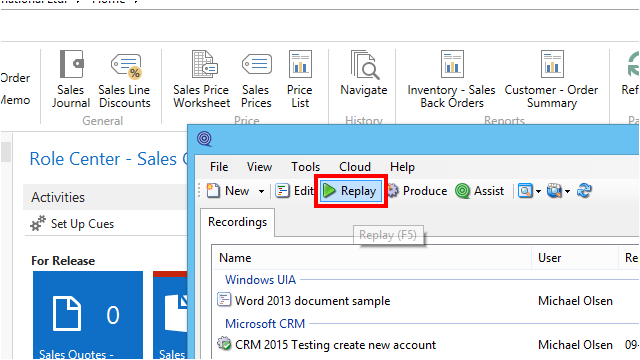

Click on the button Replay.
You may also press Alt+R.

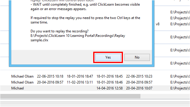

Click on the button Yes.
You may also press Alt+Y.

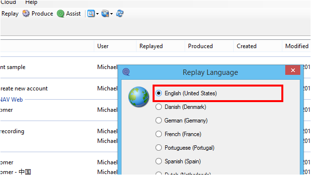

Make sure to select the correct language, as it is possible to replay the same recording back on different language versions of your application.
Click on the radio button English (United States).

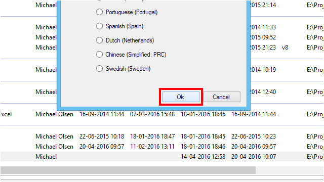

Click on the button Ok.
You may also press Alt+O.

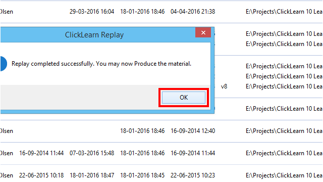

The replay is now running and ClickLearn is hidden.
Click on the button OK.
When the replay has completed remember to produce the material.
